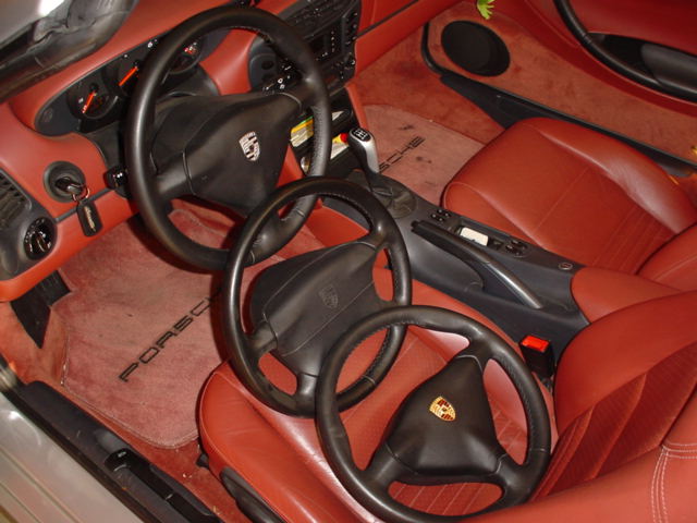

I want to take off my old trusty old 4-spoke steering wheel from my '97 Boxster and shove it on ebay (with no reserve)
What I would like help on is.....
Will a 3-spoke from say, a 2001 car or whatever fit my 1997 without problems?

Guys - I would like to thank you for your kind help - and now, I need more :huh:
Today I fitted the steering wheel airbag to the 3-spoke steering wheel I found on UK eBay a week or so after posting this topic.
The steering wheel, as you rightly say, came without airbag, but £48. I sold my 4-spoke on eBay to a guy in Germany, he paid me £37 plus £18 postage.
I searched high & low for that airbag, then, on Sunday, someone listed one for £250 plus £10 postage "buy now" - I did.
It arrived this morning and despite the freezing cold I couldn't wait to fit it.....problem.....
Looks fantastic but wichever way round I connected the airbag wire, the airbag light in the dash stays on. Turn the ingnition off, then on and the light comes on, goes off for 1 second then comes back on and stays on - any help appreciated please?
Why is it doing this? I dont want to just remove the bulb from the dash.
