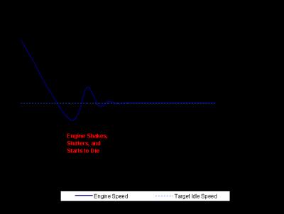

Graph of Idle Problem:
I learned of a "DME upgrade" for the engine control software/calibration. Porsche has identified this problem to be engine computer calibration related. Here is a list of other possible causes -
1. Idle Air Bypass Valve Hysteresis (Sticking)
2. Mass Air Flow Sensor – Inaccurate at low engine speed transient conditions
3. Intake Manifold Pressure Sensor, Intake Manifold Temperature Sensor, or Throttle Position Sensor in-range failure/out-of-specification – could effect air flow prediction calculation (not likely, Mass Air Flow Sensor should perform this measurement)
4. Higher than expected accessory load from the air conditioner, etc.
5. Intake manifold air leak (not likely, would result in higher idle speeds, not lower)
6. Software expecting low accessory loads and/or gain is too slow to react at higher accessory loads. (not likely, problem would be much more wide-spread?)
7. Fuel injection quantity too low or Oxygen Sensor incorrectly reading Air/Fuel ratio (not likely a fuel system problem, most likely air-control related)
