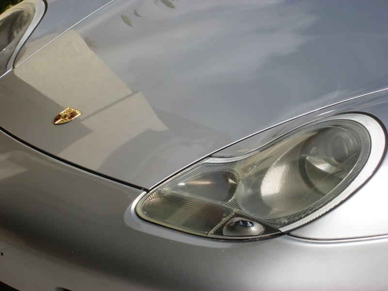

I love my '01 996, but the '02+ nose and headlights are unquestionably sleeker and more attractive to me. My present headlights are yellowing and the laminate eroding anyway, so I figure I might replace the headlights and the nose with the newer style of both.
I'll probably buy the components on eBay and have someone other than Hoehn do the installation. Does anyone have any experience with this? Thanks.
