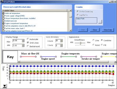

From the Duarmetric website...
You can plot any actual readings.
