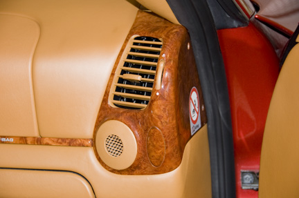

Just tracking down a couple of interior creaks, and I traced one to the passenger side dash air vent. I looked on this site and found that the piece is held in place by 3 screws--two on the side and one behind the cover for the temp sensor. I removed these three and the piece still seems attached. rather than break this really expensive (wood) piece, I thought I should ask the experts here. . .
Along with the screws, is this piece also clipped in place? Suggesions welcome. Thanks!
After removing the 3 screws you have to pull it back ward, you can lift the superior trim a little with a small screwdriver, can be hard. Give a special look to the connection shaft at the inside of the air vent after installation, the shaft can come loose and the open - close function doesnt work.
