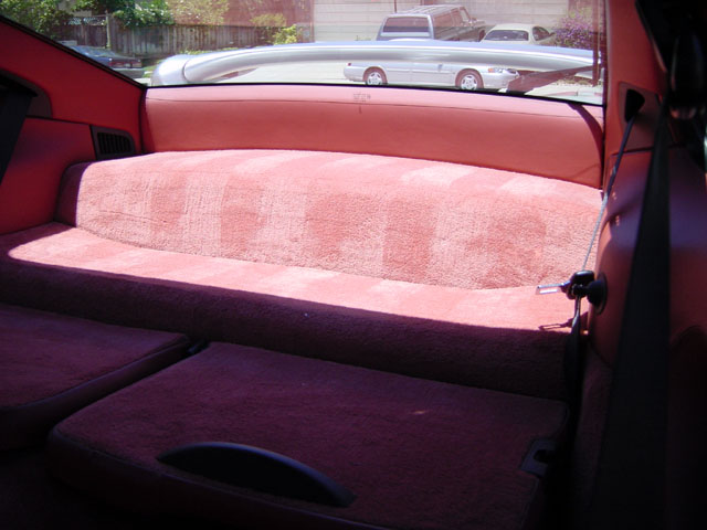

I think I cleaned the connectors on the wrong ECU. Is the engine ECU under the RR seat? How do you get to it?
The box under the driver seat is the alarm/central locking control box - not the DME.
The DME is behind a panel that is behind the rear seats. Once you remove the cover you need to remove the bolts that hold the DME cover plate so you can access the DME.
