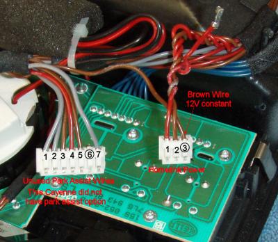

I had the the same problem when I added the Homelink components. The Red #3 wire was not hot. My Cayenne did not have the park assist option so I used the hot Brown #6 wire from the unused Park Assist connector.

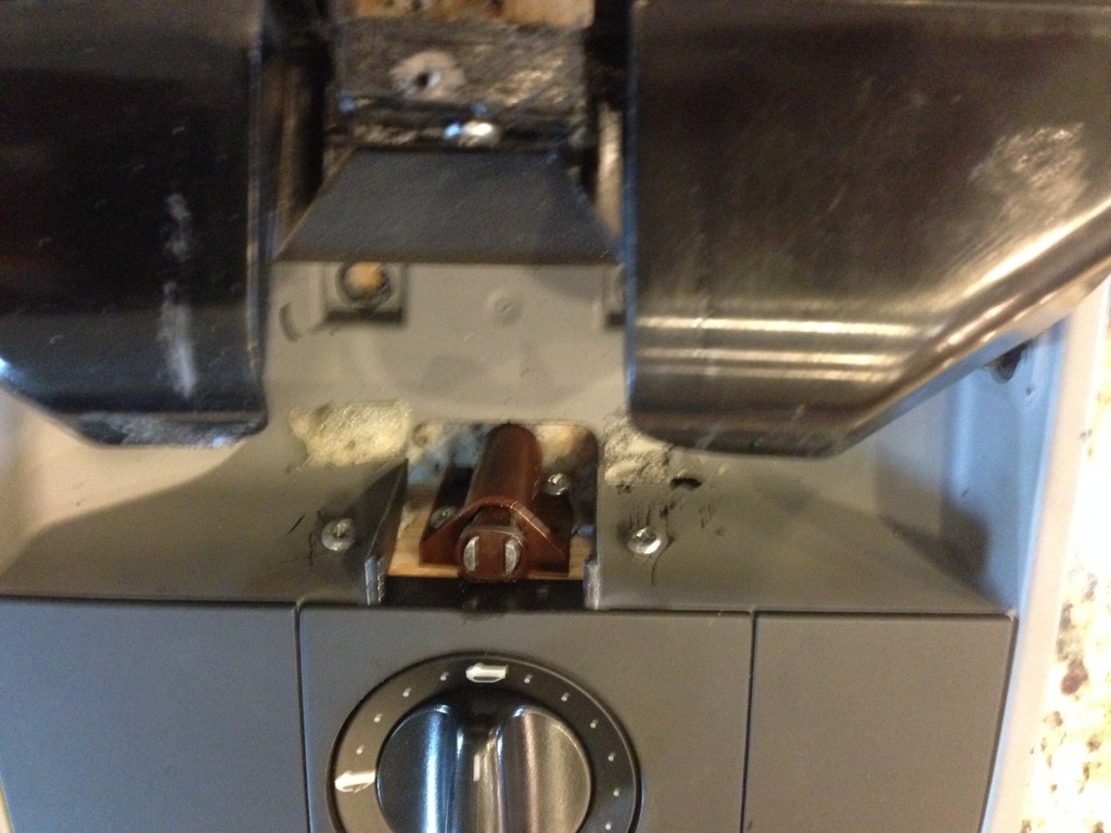

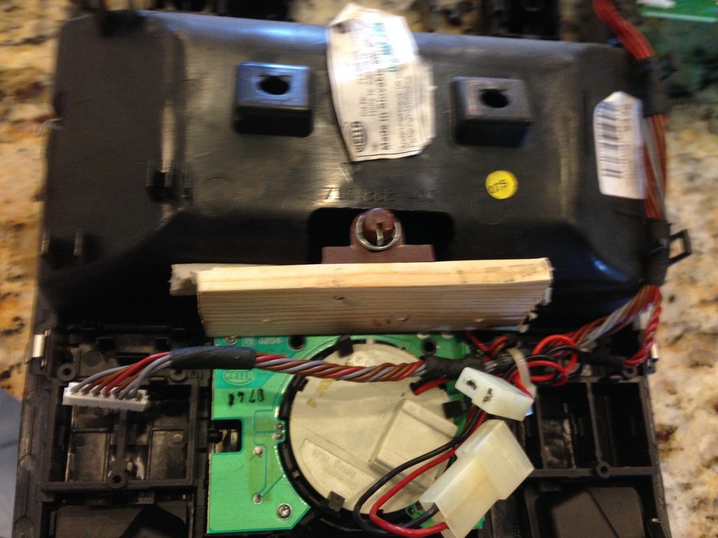

That is a great solution, mine also didn't have a switched supply so I connected it up and now it all works.  Had to replace a 'redneck repair' I guess PO installed kitchen cupboards...?  So bought the coplete thing from ebay with the homelink stuff and fitted it into the cayenne.  Had to paint the unit but all in all 2 hr's work and I can delete the remotes from the sunvisor.  Thanks for the wiring tip it worked out great!!!
