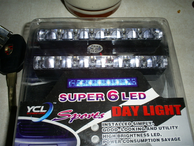

Tools U will need - 1 pair LED Lights, 4 butt splice connector, wire stripper, 12V tester
working Time - Approximately 45 minutes that's with drinking 2 bottles of Heineken
I ended up going with this LED fog's,Super white w/ slight tint of purplish blue <- just what I was looking for(4.5" x 0.5").

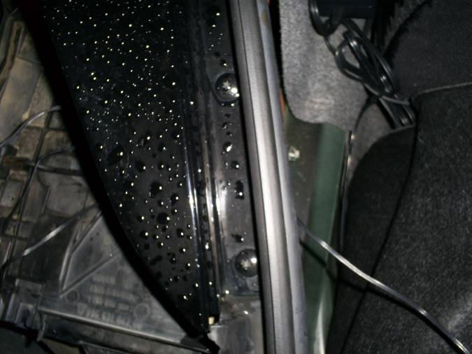

I found out that the easiest way to run the wires would had to be through the front headlight housing
both front headlights were removed to feed the wires
mounted, tapped W/ Ignition ACC

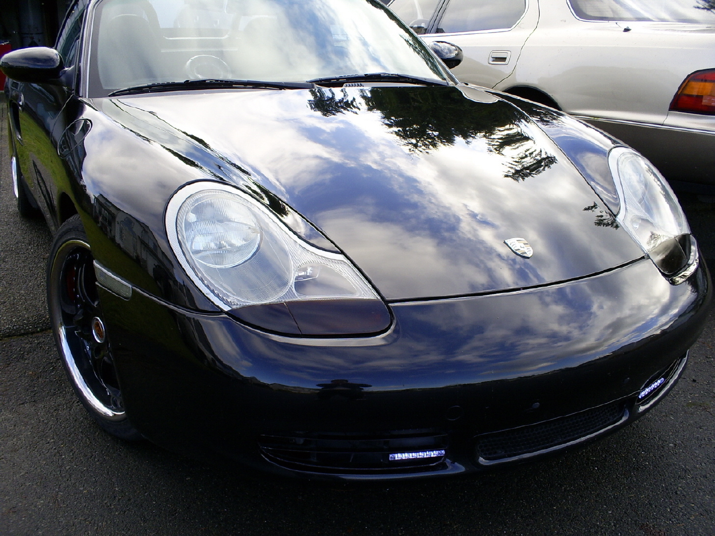

She is all finished,looking better than ever :)

Thanks speedster! yup many ppl like em,,,
yup I could've gotten something bigger but then I 'll have to modify my S front grill.
Yes , it would be cool to have matching led front signals.
It looks great!!! Any a little bigger, like the turbo? Think about hooking it up to the turn signal relay? That may look cool too.

1.used a pair of 3M double sided tape that came with-alcohol well cleaned+tiny drop of clear silicone adhesive
2.yes but not under the bumper. Once U removed the head housing, will be able to fish the wire inside the bumper
3.power consumption for these lights is almost 0 :D , tapped with phone ready switched circuit in the bottom center console
