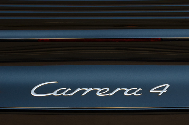

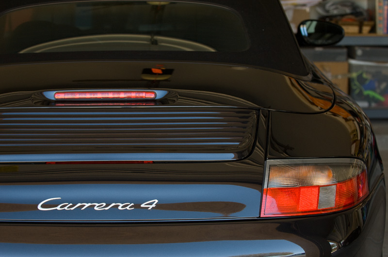

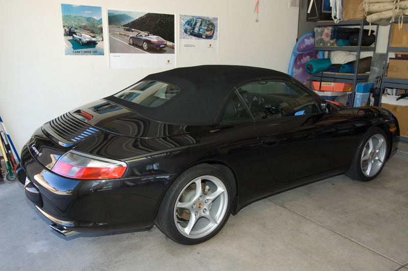

Thank you for the inputs! Along with your suggestions, I did additional research and wound up using a porter cable with Sonus Polish and am very happy with the results. My 2003 Basalt Black paint, which had swirls and light abrasions from the prior owner, looks brand new!
thank you!
