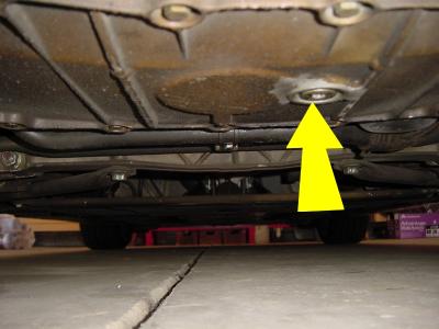

Look at the DIY diagrams for oil change and manual transmission oil change (assuming your car is a 6 speed) and see which looks like the drain you removed.
This is the oil drain plug - an 8 mm hex (as I recall). The clean area.
Thanks so much Loren, I found the drain plug!
I'm draining the oil now, but now I need to replenish the fluid I accidentally drained earlier. I drained it from the rear center, the pan in between the wheels. Was this the transmission fluid? How do I now replace it? Thanks again!
