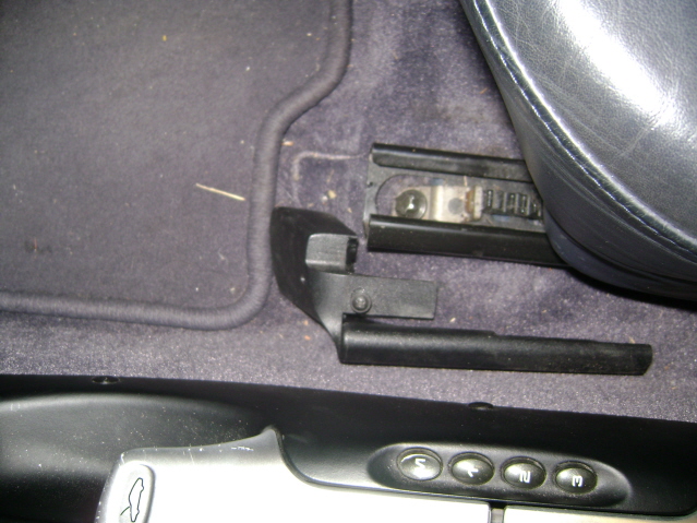

Im trying to mount a Recaro SRD sport seat in my 996 and need to find the correct rails.
I cant use my 996 rails on the recaro bracket and it would be a PITA to try to bolt my recaro SRD seat onto my existing 996 bracket and rails.
The 996 rails bend down at a 45 degree angle in the front, so I need to find the recaro equivalents. Can anybody recommend a good source?

996 mount pic :
Recaro mount pic:
