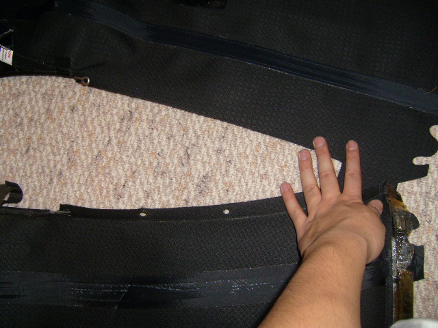

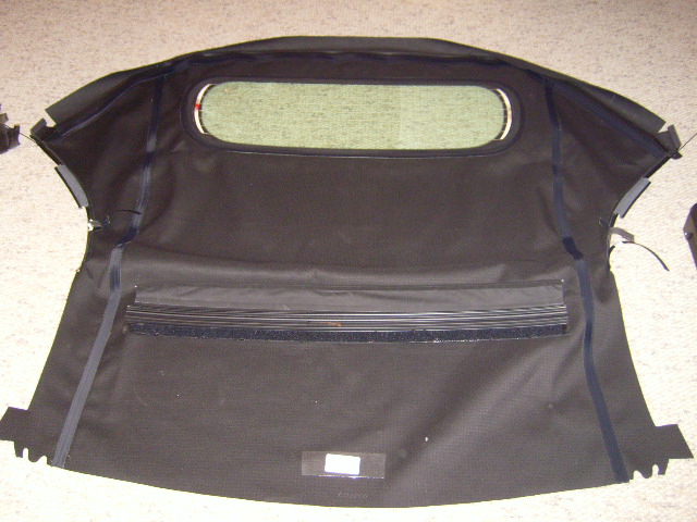

I took some pictures of my old Foam seal, Old top vs Robbins glass top.
Old Top
New Robbins Glass top
where the U-shape frame is.
Bottom (Old Top) and Top (Robbins Glass top)
Robbins top does not have 4 holes for Phillips screws. Would I have problem with installing without these holes?
Old Foam Seal. No volume to the foal at all.

Sean:
Good work. Sounds and looks like you are making progress.
The reason that there is no volume to the old foam seals is because they have been compressed under the aluminum shoulder plates for many years. Take a look at the photos of the new factory seals that I posted on the other thread (jimyboyle thread) to get an idea of what they look like when they are brand new and have not been compressed.
As far as the 4 holes for the Phillips screws, you definitely have to make new holes for the screws to fit through after that edge of the top is folded over onto the small sides of the aluminum shoulder plates.
These 4 holes (on each side) are in the four areas that you must cut out the foam seals so that the phillips screws don't get caught up in the foam when you are tightening down the aluminum shoulder plates onto the black metal frame of the top mechanism that is over the windows.
One last point. Remember to clean all of the areas where you will be installing the 3M double sided tape thoroughly so that you get a decent bond. If there is any grease or oil or fingerprints on those areas, the 3M tape won't stick that well.
