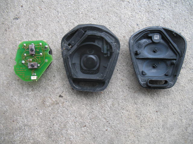

The key head is 2 plastic parts that snap together. If the chewed part is the half with the buttons, then Porsche sells just that part so you do not have to buy the entire remote,
Thanks TP,
It is exactly that, the buttons look like the previous owner had a nervous disposition and used the key to repress his anxeity by chewing on the them. He did so it much that they are dificult to press. Could have been whilst waiting for his service bill in a UK OPC.
