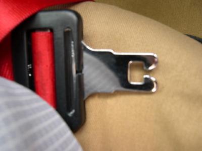

It is a bar that is installed under the passenger seat when a Porsche baby seat is installed it has a seatbelt-like connection that deactivates the airbags. Here is a link with an example of one installed.

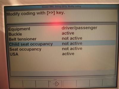

I purchased the de-activation bar from Suncoast. Physically a simple install, two bolts and a plug. Has anyone done this themselves, or is a reprogram required? Thanks!
Yes, if the bar activation is not "on" it will need to be turned on.
If that is the case then you need to find someone with a PST2 or PIWIS tester.
If that is the case then you need to find someone with a PST2 oe PIWIS tester.
You have to plug the two wire connector into a plug on the bottom of the seat (usually taped) AND the feature needs to be turned on with a PST2 or PIWIS tester.

You'll need the male portion of the buckle, that is attached to the Porsche child seat, plugged into onto the female portion of the buckle that is part of the deactivation bar.
The deactivation bar is installed under the passenger seat, and the cars computer settings are modified with a Porsche System Tester (PST2 or PIWIS) usually at the dealer, to acknowledge the bar and to turn off the passenger side air bags when the above mentioned buckles are connected.
Once the bar is installed and "activated" you can use any child seat provided you can get a hold of the male portion of the buckle or replicate it by modifying a used seat buckle or fabricating one with patterns available on the net.
