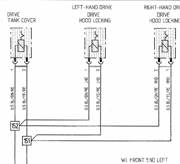

Can you open the fuel filler lid?
They are on the same circuit. Both are controller by the Alarm/Central Locking control box. So, if there is not a bad connection or broken wire then you may need a PST2 or PIWIS to troubleshoot it.
Interesting.. Yes, I can open the filler lid without any problems.

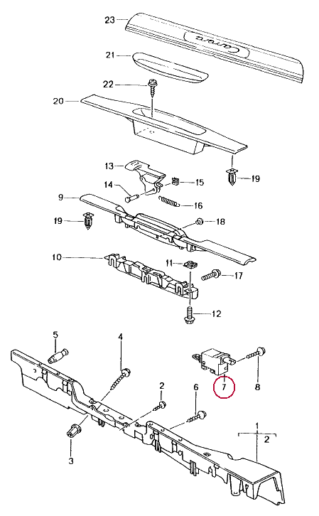

Is the engine compartment locking on the same circuit too? I don't see that on the diagram. I'm unable to open that by the lever also.
Thanks.. I'll remove it and have a look.
FYI: I removed the lever assembly and found that the solenoid was fine, but that the wire hook from the solenoid to the locking mechanism had become disengaged.. I realigned it and reassembled.. no problems..
