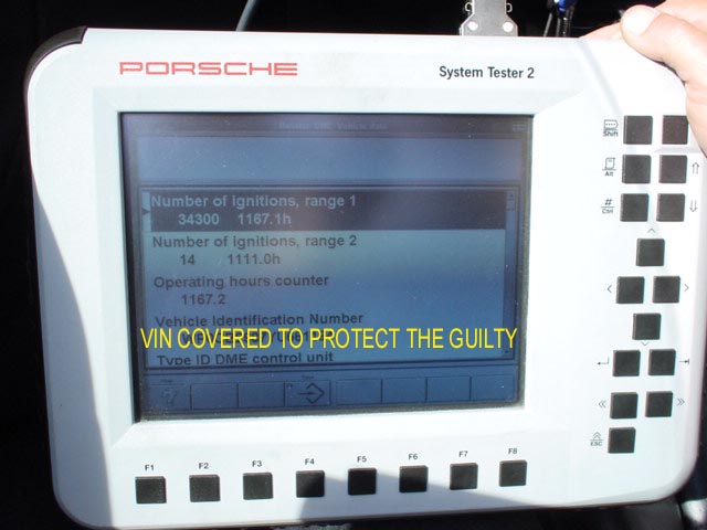

If you were in 9,500 then you were in at least range 5. What I think is important is when did it happen in relationship to the engine failure. That is why you need to look at the engine operating hours for the 9,500 incident, and compare that number with the number for the total engine operating hours.
This is an example. A local 2000 Boxster S. We went on a drive from San Jose to Santa Cruz, about an hour drive. Upon arrival in Santa Cruz we had out cars hooked up to a PST2.
Engine operating hours is 1,167.2. The car got into range 1 at 1,167.1 hours. So that means the car got into range 1 on the drive. Range 1 however means nothing.
Last range 2 was at 1,111 operating hours. Range 2 can damage the engine. But the last range 2 was 56.2 engine operating hours earlier. So if the engine had failed during the drive it would not be because it had been in range 2 56.2 operating hours earlier.
