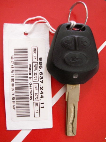

Want a spare key. I recently purchased a (used) key fob and (new) blank. According to the seller, once the blank is cut, the key fob can be reprogrammed. However, I've read in this forum that a key fob cannot be programmed a second time. Please confirm.
You cannot program a remote, new or used, to the car unless you have the paper tag that came with the remote. That tag has a 24 digit code on it. You program the control unit under the seat for the remote, not the remote for the control unit. Without the paper tag or code you are out of luck. This is why I tell people to avoid ebay/used remotes.
You cannot program a remote, new or used, to the car unless you have the paper tag that came with the remote. That tape has a 24 digit code on it. You program the control unit under the seat, not the remote. Without the paper tag or code you are out of luck

I needed a spare key a few weeks ago and so I took it into the dealer to be programmed. Unfortunately, they deleted the original key from the computer. Because I didn't have the 24 digit code for that key, it became useless! They had to order me another key to replace it. When I was back in to get that key programmed, I asked the mechanic about getting the code out of the PIWIS and he said that it only shows part of the code. Not the full 24 digits. It is just used to identify which memory position (i.e P1, P2) the key is programmed. So hang onto those key code tags!!
