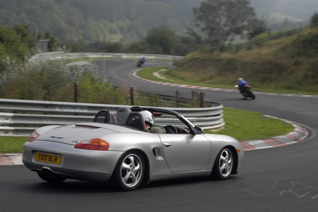

The car is a 99 2.5, she does alot of trackdays and alot of driving at the Nurburgring where she can get round in just over 9 mins. :D
