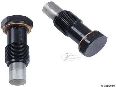

The reason I mentioned the tensioner is that your engine is a version of the VW VR6 and that noise sounds very close to the noise caused when the tensioner looses oil pressure from sitting over night or even a few hours sometimes. If you have a vacuum leak then I suggest finding a garage with a smoke tester as they should be able to locate the leak in a matter of minutes.
On the VW engine the tensioner can be changed easily, it just threads into the side of the rear timing chain cover.

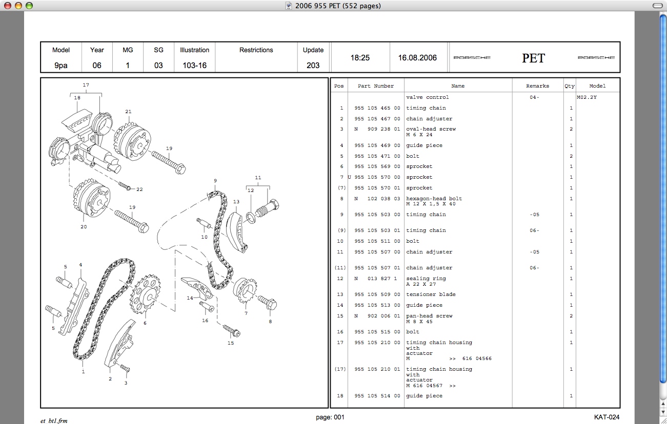

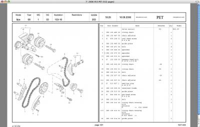

You don't have to remove the timing chain cover, the tensioner threads into the housing and thats all you have to remove. I'll try and post a pic later.
It's item 11 in the attached pic. It's just unthreads from the timing chain cover and it's located on the R/Rear of the engine under the intake manifold area.
Thanks for helping me, it's really appreciated. I sent this video to porsche dealer, spoke with many specialized people and NO one else was able to find the problem. What you told me is very logical, because when the engine is cold the upper tensioner is loose and knoking and when oil pressure slowly come into the hydrolic tensioner (probably defect and slow to react) the noise come off slowly. This also explain the misfire on cyl 1 and cyl 5 because the loose chain may disturb the timing a little bit during the warmup.
I just want to know when I'll replace this part, if I need to secure the timing chain or I can safely just change the "bolt" without droping a guide or a rail in the bottom of the case. I probably need also to bleed the part with oil before replace it with a new o ring.
Thank you very much, I was trying to resolve this since two year and I think I'm very close to tell you... You are the best.
When you remove the tensioner nothing will move or become dislodged, just don't turn the engine over with the tensioner loose or removed. The old tensioners wear and loose their oil charge when sitting for a time and then it needs to bleed and refill with oil. The new unit will self bleed but it may take a few minutes for this to occur.
