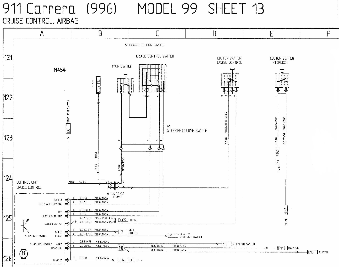

First of all I appreciate all the help I have received from this site. I have a 99' Cab - 6 speed. My cruise symbol comes on but does not engage. I replaced my brake switch -- same thing. Now do I replace the clutch switch ????????
I need to fix as I am driving to the Charlotte Porsche Parade ---- Hope to see some people from Renn Tech.
