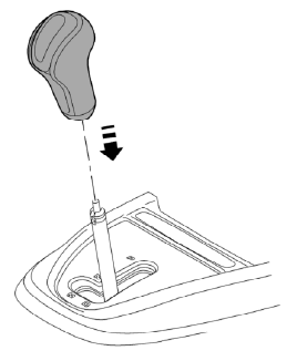

Removing selector knob
Note: The ignition key must be in position 1 before the locking button can be pressed.
1. Press locking button and release lug under the locking button in direction of travel using an Allen key, for example.
2. Pull off locking button against the direction of travel.
3. Use a screwdriver to lever the spring clip out of the lock.
4. Pull selector knob up and off the selector lever.
Installing selector knob
1. Push spring clip all the way back.
2. Fit locking button.
3. Push complete selector knob over the lock and all the way onto the selector lever.
