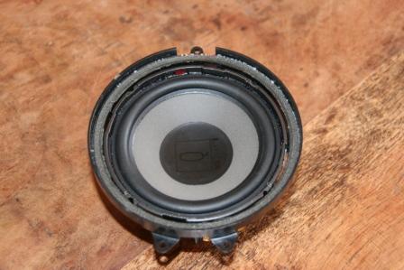

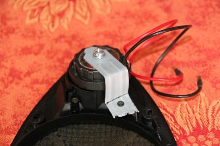

MB Quart QSD 213 as the front speaker, tweeter only in the dash, 5-1/4" to replace the factory door speakers.
conclusion: don't dream about any decent bass with 5-1/4". medium/high are great.
I also replaced Rear speaker with QSD210.
Cutting the old speakers was the solution to mount the 4" speaker (see pictures).
Just got an MBQuart PAB5400 amplifier and a Clarion MAX983HD Head unit, since Pioneer still does not ship F900BT in France.

I now need to decide if I replace the 5-1/4" door speakers with Kicker CVT65 + proper Dynamat install+ 4" in dash, or have a sub installed behind the back seats.
Since the sub boxes I found for 996 will never pass the W.A.F (Women Acceptance Factor), I might go for the Kicker option.

Is the stereo image good with 4" in the dash (I hated the factory sound)?

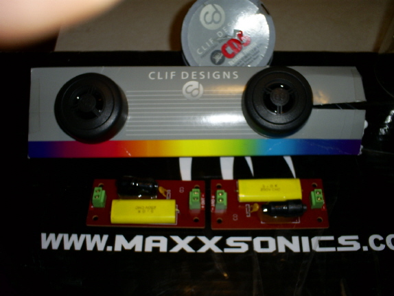

I got 3 pairs tweets in they are all Cliff Design titanium dome.

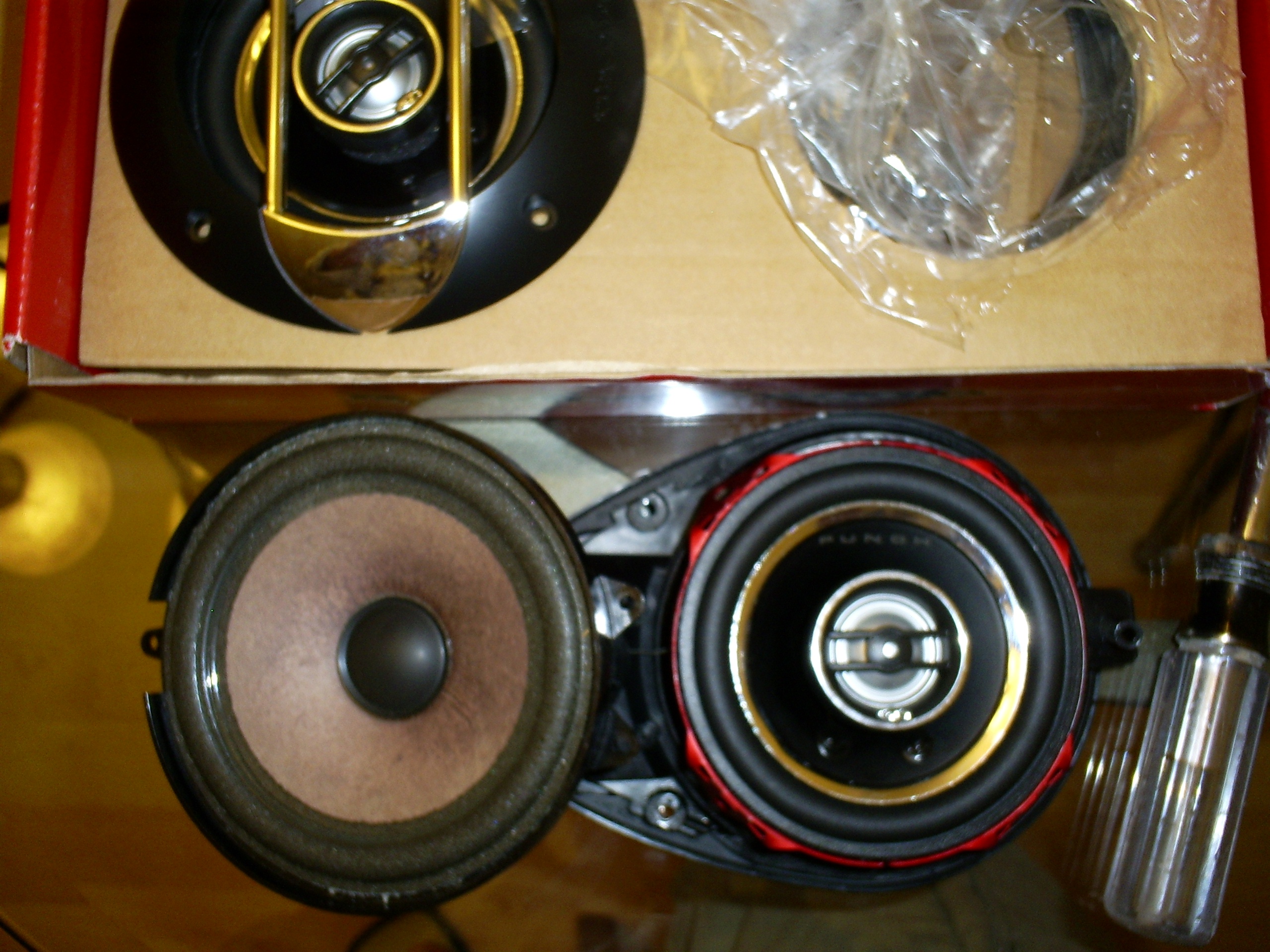

Did the rf's drop in (with the usual mods) or did it take more than that?

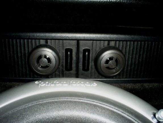

Regarding the tweeters, I trust you didn't opt for the stock install look, what with 3 pair.
Where did you put them all?
Okay juniinc, that picture just begged another question. I can see the one pair of tweeters installed in the middle of rear storage cabinet and I trust the other pair on the outside of said cabinet. But my question is, what the heck is that at the bottom of the picture? Sure looks like a speaker.

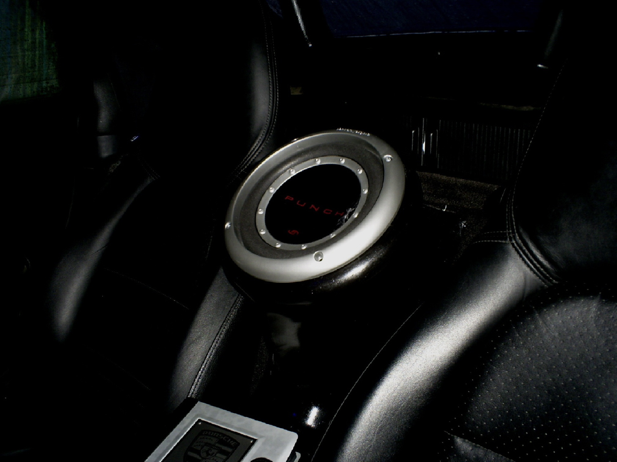

As far as subs/top down is concerned, Imagine a heavy duty real 8" sub, with a lot of excursion, in a sealed .4 cu ft fiberglass and wood footwell enclosure, with 200wrms of class D amp power pumping 30-50hz bass into the footwell.....and up under your wife's skirt....
http://pics.realmofexcursion.com/albums/us...01/DCP_2762.jpg
Very healthy bass even with the top down, or at 80 mph.
Wife's 4'10", so leg room is not a problem..:)
....so the wife likes the NEW sub better I imagine....... :P
