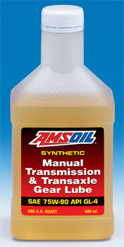

97-99 manual tranny was almost idenical to the Audi A4's.
But the factory LSD wasn't availble, however GL-4 oils are for transmissions that contain brass or bronze parts.
GL5 oils differ from the GL4 oils in the EP additive. The most known EP additive is a phosphorous-sulfur compound that is corrosive to brass at the concentration used in a GL-5 oil,,,
There are GL4 ratings out there like Pentosin ATF we used on a few older jettas & Amsoil Synthetic API GL4 75W-90 would be my choice.
