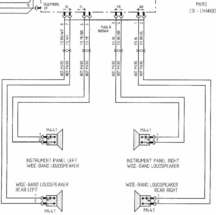

Here are the correct pin outs for no amp.

They are likely using the wrong pin outs.
My apologies. I was just basing this assumption on what I've seen. I should have done some research.
Your friend should wire up to socket B http://www.beckerautosound.com/pdf_guides/om43-4462.pdf
It says it outputs 18watts x 4, so it's probably going to sound tinny if he's using higher than 20watt speakers or if he has more than 4 speakers wired in as there's not enough power to drive them.
