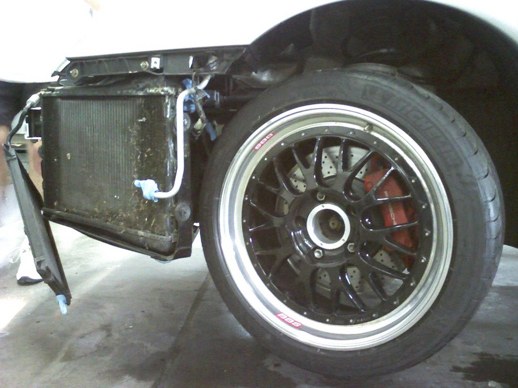

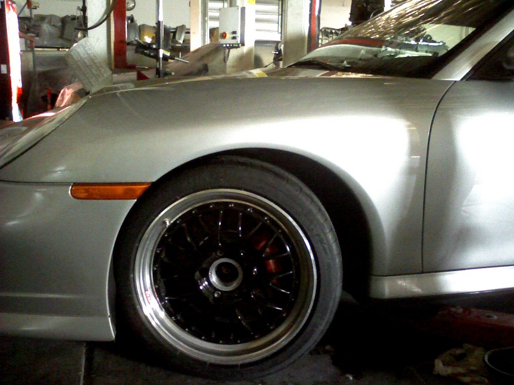

I'm finding that BBS wheels in a GT2 size/offset are unable to fit in my C4S fender well - they rub - actually push the forward fender liner when turning to full lock. (Especially where the radiator bulge is.) As it's quite common for Turbo owners to use GT2 wheels, I was wondering if anyone else found their radiators were getting in the way - through the fender liner?
Here's a very bad photo illustrating the problem:
To address this, the shop is trying to move the radiator forward slightly, but that's introducing a whole can of worms with fitting the ducts/bumpers/etc - and I really don't want cooling airflow and/or aerodynamic airflow to be adversely affected.
But, this seems a very odd problem, since the front wheel wells should be the same between the C4S/Turbo/GT2. The forward fender liner clearance issue is very puzzling. Any insite from you all would be greatly appreciated!

Sorry for the ommision... The Wheels are BBS E88's, in (supposedly) stock GT2 sizing - 8.5x18 ET 40 front, and 12x18 ET 45 rear. Tires are the recommended GT2 fitment Michelin PS2s, in 235/40/18 (N2) front, and 315/30/18 (N2) rear. Thanks!

I had wondered about that... but the wheels did fit just fine on the previous owners' Turbo and GT2. I also had my allignment checked, and nothing unusual was found.
