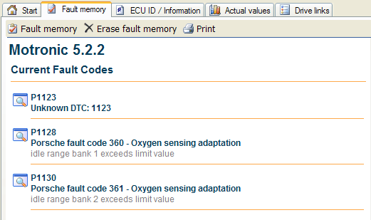

P1123 Oxygen Sensing Adaptation Area 1 (Cylinders 1 - 3) - Lean Threshold
This the mixture is too rich - but only on bank 1. Odd with the 1128 and 1130.
Hmm... MAF?
P1128 Oxygen Sensing Adaptation Area 2 (Cylinders 1 - 3) - Rich Threshold
P1130 Oxygen Sensing Adaptation Area 2 (Cylinders 4 - 6) - Rich Threshold
This says that DME can not make the mixture rich enough - that is, you have too much air getting into the engine.
Could be a bad MAF, a leaking AOS, or even a broken oil filler tube.
- Intake air system leaking.
- Fuel pressure too low.
- Volume supply of fuel pump too low.
- Fuel injectors fouled.
Loren, thanks for the quick reply.
The oil filler tube was replaced at 60k, probably not that.
I'll take a closer look at the AOS to see if anything is leaking or appears to be starting to.
The MAF was pretty dirty. I followed the procedure on Mike Focke's site, cleaned it, put it back in.
The wife and I just got back from a 40 minute, after dinner run on Pacific Coast Highway......no CEL lights.
Hmm... MAF?
I had the 1128 and the 1130 last week, and while driving the CEL flickered and the engine felt like it was stuttering. It is new MAF time. That is where I would start. ('01 Boxster S w/ 103,000 miles)

(Wams - 09/09/2008) Several month ago, I had the same 3 codes on my '99 Carrera. I only replaced the MAF (procured it from Autohaus Arizona, http://www.autohausaz.com/), reset the computer and since then no more issues with MAF/O2 sensors.
