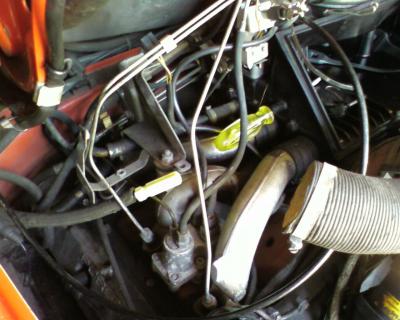

In the process of resolving a spark plug issue I discovered this situation. There appears to be hose connection to the air box and I discovered a cut hose nearby the air box.
The cut hose goes into the vehicle on the drivers side under and in front of the Fuel Filter.
Does this hose go into the air box?
Any Ideas?
There are yellow screwdrivers indicating the hose and air box.

My first guess is that these are smog pump and gas vapor related connections. I think the hose on the left runs up to the front of the car for emission related venting. It's an SC, right? was there a smog pump connected at some point?
