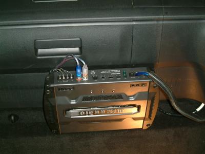

Hi Everyone I have completed the speaker addition to my 2007 useing the 986 rear speaker kit which cost me $118. on ebay and $125. for a mtx rfl 202 amplifier from https://www.12v-electronics.com/catalog/acc...hp?order_id=506 and it works excellent. finally sound all around. the door speakers connected up to the amp and it turns on automatically when the radio or stereo is tunrned on.
the one thing that was a god sent was I had the older storage unit that came with my car so that was a plus and easy install on the speakers while still retaining my rear storage compartment. So any one wanting more sound from the standard 7 speaker sound system this is the way to go. You will see in the picture above the amp in the front trunk which I velcroed on so its removable. Also there was no drilling for the wireing as it ran through the rubber gromets in the front frame between the trunk and battery compartment.

I hope this has been helpfull to who ever wants to upgrade without spending a fortune. By the way I did most of the installation of the amp, wiring,and speaker install, at the end I had a proffesional do the final hook up and it cost me $59.
Anyone wanting more information on how I did the install of the amp and such let me know and I would be more than happy to share.
