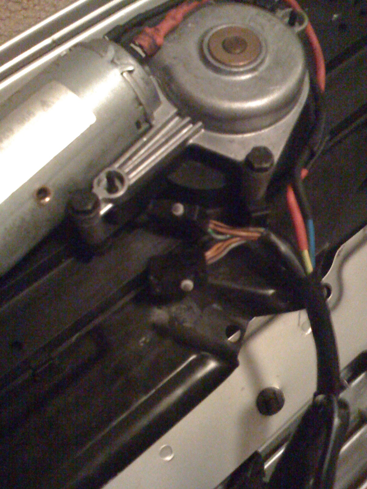

I recently removed my stock decklid and replaced it with a GT3 decklid and wing. I am looking to temporarily go back to my stock decklid (change it up for a little bit), but I can not remember how the a part of the stock wiring connects. More specifically, the two small "box" type pieces with pressure buttons on them located next to the decklid motor... Where do they go? What are they for? Any help would be greatly appreciated! I have included a photo of the specific piece I am referring too.

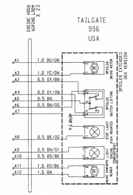

I figured out the wring and colors on the plug, but it does not show where they rest or attach too... Any thoughts?

I think I am still a little confused...
I know the wiring harness is for the spoiler motor, brake light and fan (attached to the deck lid). Where I am confused is where the two "black box" pieces go, which are a part of the wiring harness. If you look in the center of the picture, you will see two small box shaped pieces with little button type (you can push on them and they click) things on the top. The way the wiring is wrapped around the deck lid motor, I have no idea where they go. Do they go inside the moving parts for lifting the deck lid? Do they just float freely and not connect to anything?
Does this help? Sorry for the back and forth... I am just not seeing how they attach to the deck lid...
