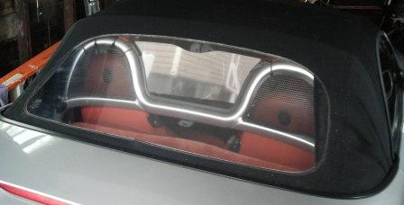

Here are a couple solutions for those who have mechanical problems with the top, and/or cracks in the rear plastic window AND have little or no money for repairs/replacement.
Issue 1. My 1998 986 had nearly all of the top mechanisms removed when I bought it. The transmissions, pushrods and cables were gone. Iinitially, I bought replacements of all these on ebay, intending to re-install. But I have since found that it is almost as easy to operate the top manually, and I have done so for almost a year. Moreover, it is safer in that there's no mechanism to fail and cause a warped clamshell, an occasional occurrence.
I just grip the very back of the clamshell, right above the brake light, and pull it up and back. With the rails for it greased, it moves very smoothly. Then release the center catch and pull the top back, doing the Boxster chop; it folds nicely. Then the clamshell drops back into place easily. Since we have to get up to do the chop anyway, it's not much more trouble this way, it's just less cool looking. To put the top back up, reverse the process, except you must make sure the windows are down or doors open when closing the catch.

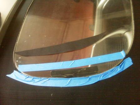

Issue 2. My rear plastic window also has cracks on the side, as is nearly inevitable after many harsh winters. I intend to get it replaced this winter, but until then, I have glued in patches of black nylon material [cut from an unused overnight bag I found in my closet]. I glued patches on using 3M windshield cement, the very sticky gooey black stuff used to glue windows into cars; applied using a caulking gun. See photos. It's not perfect, but it looks better than electrical tape, and postpones repair at very little cost.
