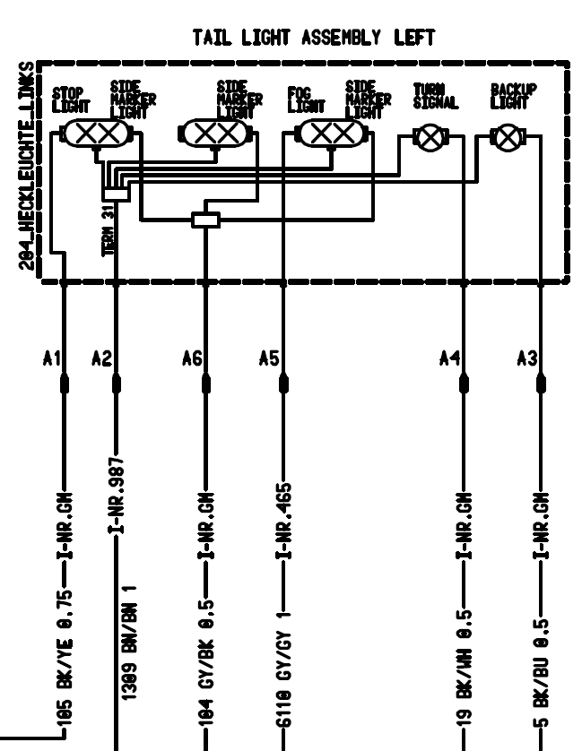

For a 2008 987 base, does anyone know the wire color codes for:
Left turn signal
Right turn signal
Brake light
taillights
I want to tap the harness a little bit away from the taillamp assembly and I want to make sure that the colors in the taillight don't differ from the harness.
