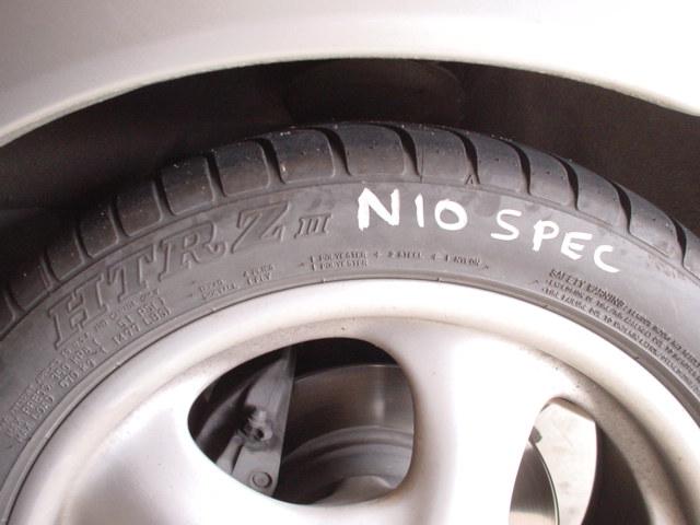

They are Sumitomo HTR Z II from TireRack. Got them 3 years ago and they were $500 for the set of 4, then had a local wheel place mount them. Good bang for the buck, but not fantastic in the wet. I have about 20,000 miles on them. They are not N rated but I could care less.

Always wondered what it would be like 20 years from now and no tire company made N tires for an old Boxster. If your are old then you may remember the 1980s Ford Mustang and the TRX wheels.
Always wondered when this N rating thing started and why. Apparently in 1985.
http://www.nichols.nu/tip493.htm

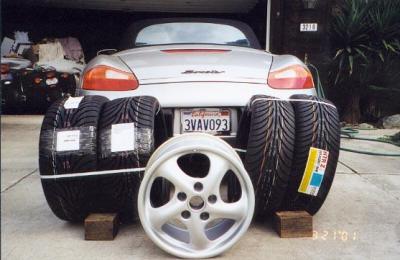

Thanks Highlander. I had also looked into the Kumhos as well but didn't know/find out much about them. Most people would just go with a SO-3 or a Michelin Pilot Sport, which are great tires but hella expensive.
I occasionally track my car and autocross it. Do you think the 712's will suffice?
My problem right now is debating whether I want to get 18" wheels to go with the new tires. I mean now is the time if I'm going to buy new tires, right? ;) I'd love a set of the Carrera Lightweights but they are pricey.
