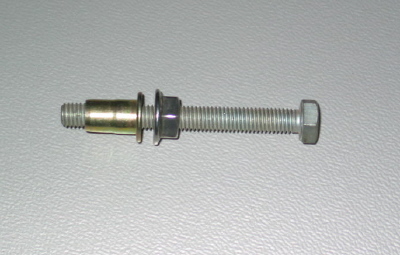

Trying to install the running boards but running into a problem... There are 6-sided holes in the lower frame and in the running board kit are the pictured 6-sided inserts -- they slide right in (but dont stay). The screws are meant to go into these to hold the running board in place. I thought maybe they were like drywall screws where they expanded when tightened but no go. They just fall out. Any ideas??
Hi Scott,
These are expander nuts which are usually fitted with a hydraulic tool, just like a rivet.
For me, it always worked with longer bolt with a spare nut.
You keep the bolt so it cannot rotate while you tighten the nut.
