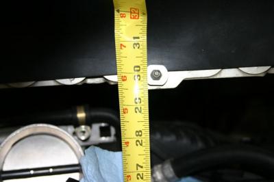

So I dropped the engine. The photos show the rear height, and front and rear jack stand heights I needed to roll the engine out the back of the car using a combination of a Sears Craftsman ATV jack to support the engine and a cheap "jack in a box" type jack to support the transmission. The ATV jack has a minimum height of about 3-3/4", and there was probably 1/2" to spare between the sheet metal and the throttle body as the engine came out:
