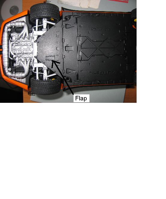

Hi Paul, I am having difficulty locating both the wire and therfore flap. Could you indicate where the cable / flap is on the attached picture of a model 997 GT3 (which is remarkably accurate and similar to my c2s underside!). I can only find one flap which I have shown on the photo and there is no cable behind it. should I be looking more in toward the rear of the car in the open section with no undertray?

Here it is on your GT-3 model.
Paul
Hi Paul, thanks for the pics. These helped me to find the connection quite easily. The big difference is that, as you mentioned my UK supplied car seems to have many more under-body panels than your car (wet UK climate perhaps). Looking at the picture I had to remove the whole triangular rear section plus some of the panel further forward to get access to the cable under another flap! Also the cable is in the right hand side of the car for both left hand drive and right hand drive cars.
Anyway, good news is that I have done it, there was some corrosion on the connection which has now been removed, treated with some moisture repellent spray (WD40) and reassembled. :rolleyes:
The great news is that initial impression is that the issue is fixed for £0 ($0)! :D Repeated hot starts have all been successfully with no sign of the starter slowing down. I withhold final judgment for a week or so of normal driving / use but initial impressions are excellent. Thanks again for you help on this as it may well have saved me a small fortune in workshop fees as well as an embarrassing breakdown.
