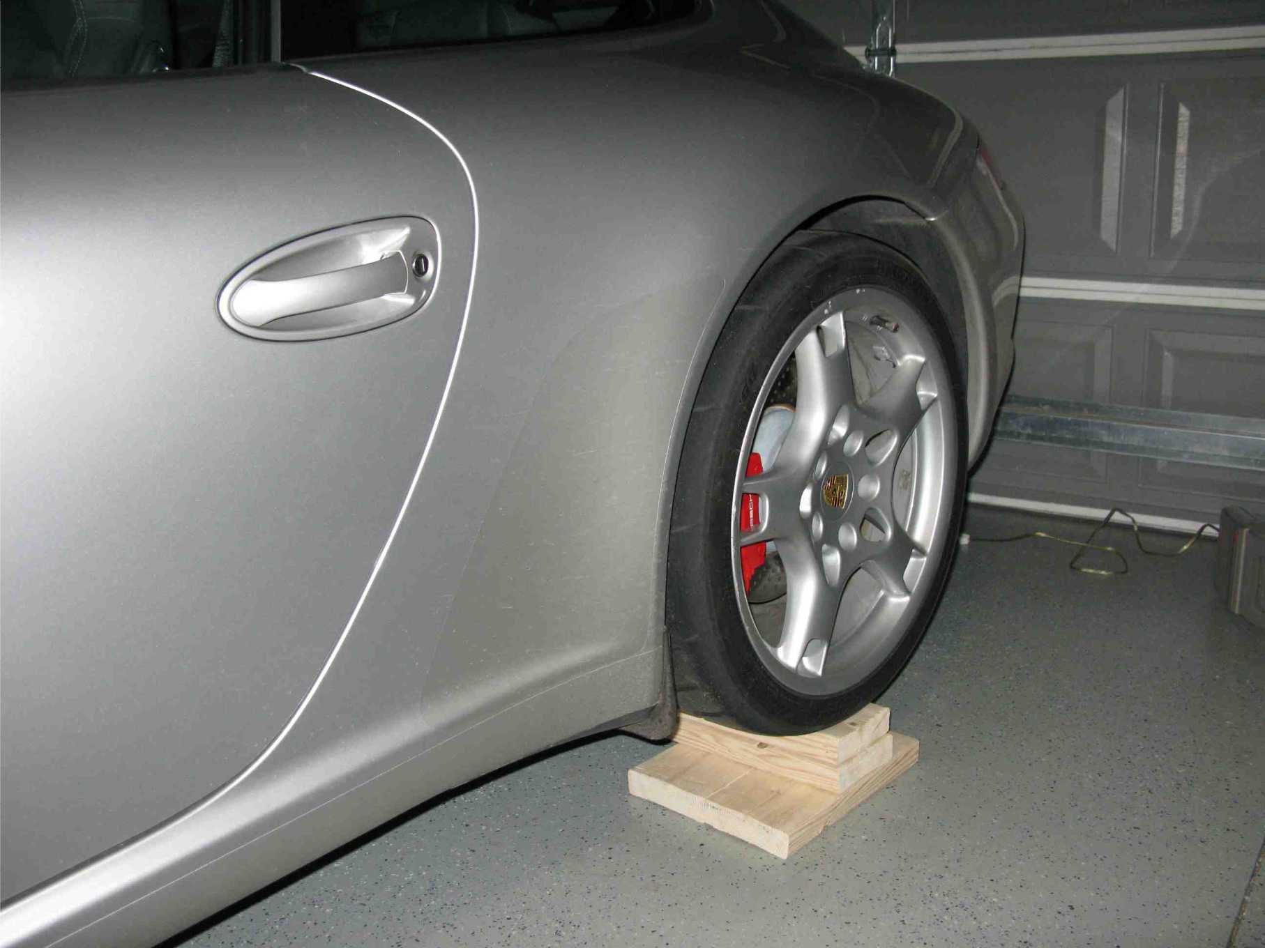

1. Lift your car and make sure you block the front wheels (picture 1.jpg).

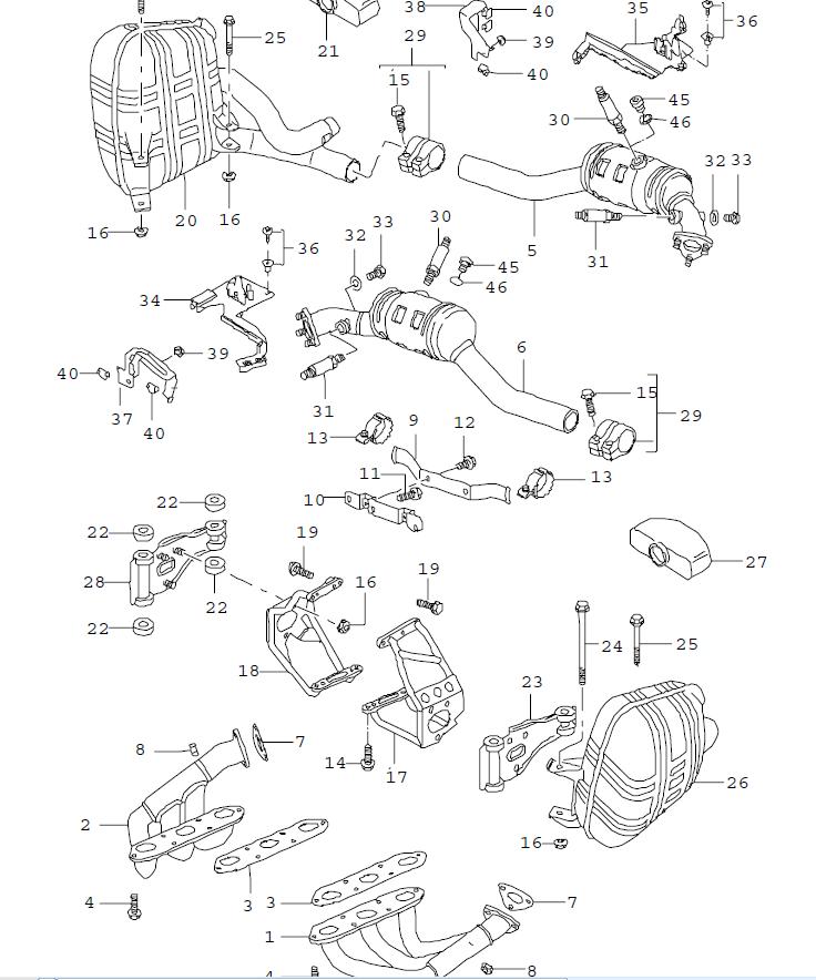

2. Tools you need: 13 mm socket 6pt, flexible 13 mm socket, 6 inch extension, torque wrench, adapters for the wrench and the 13 mm socket, 6- M8-1.25mm X30 mm bolts, 6 - M8-1.25mm hex nuts, 12-M8 flat washers, 12-99907507400 Exhaust Manifold Bolt Set - 997 (picture2.jpg). It helps if you spray on all bolts and nuts WD40 (o another brand) one or two days before you plan to uninstall the headers.

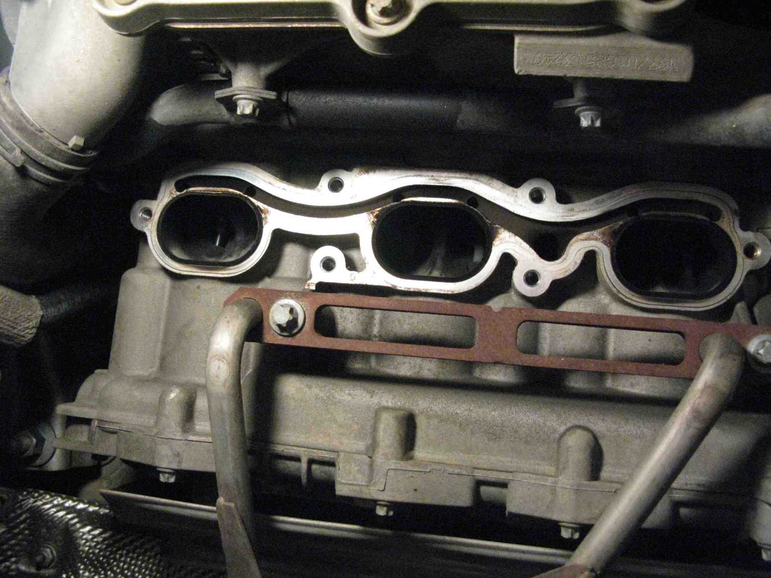

3. Partially remove 6-bolts from the part of the header connected to the engine (picture 3.jpg). Do not remove all bolts yet.

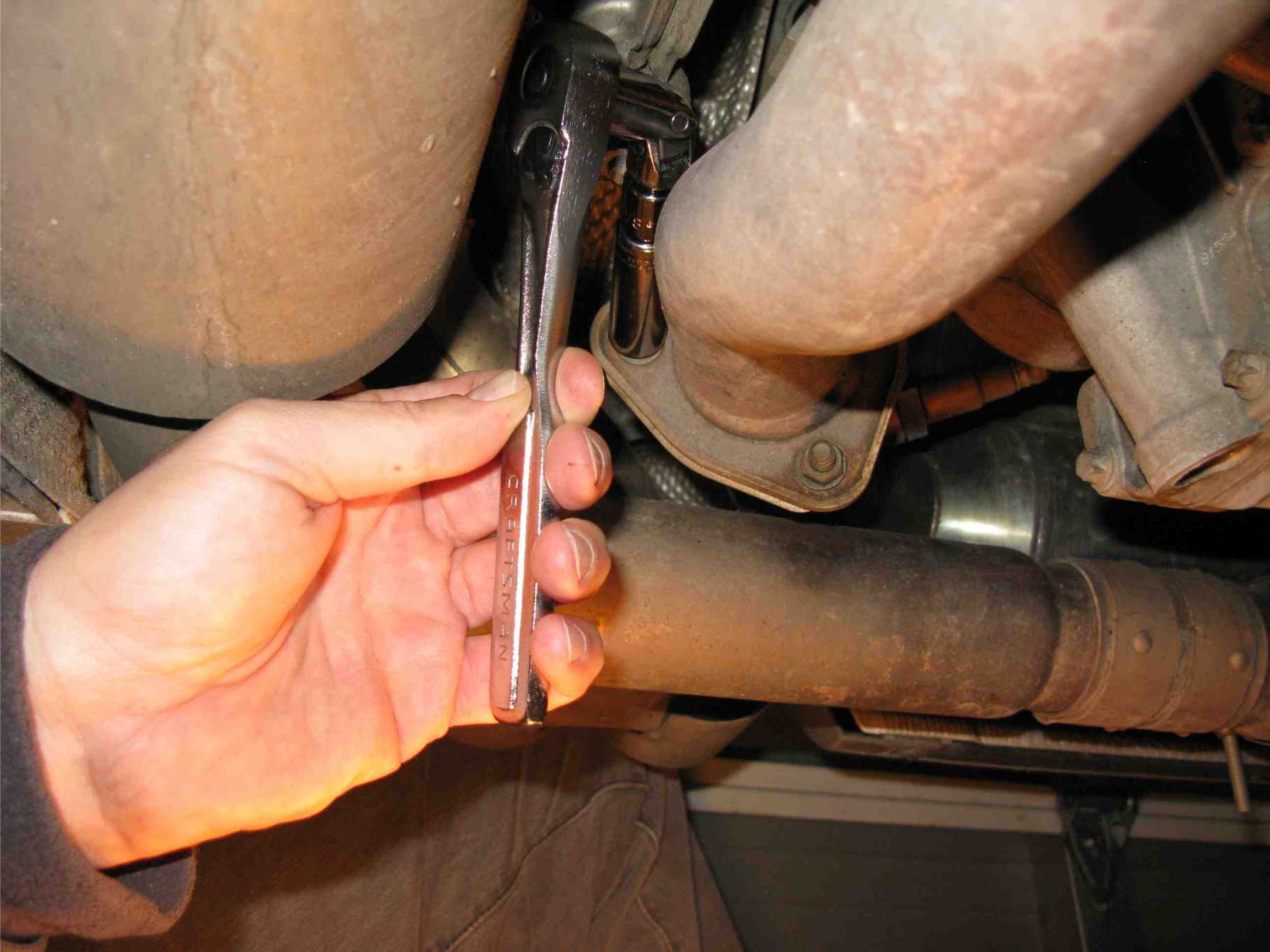

4. Partially remove 3-bolts and 3-nuts that connects the header and the cat. Be careful, make sure you have a strong and secure grip. I found this part a little bit difficult because the access is very limited. Flexible socket and extension make the job easier. (picture 4B.jpg)
