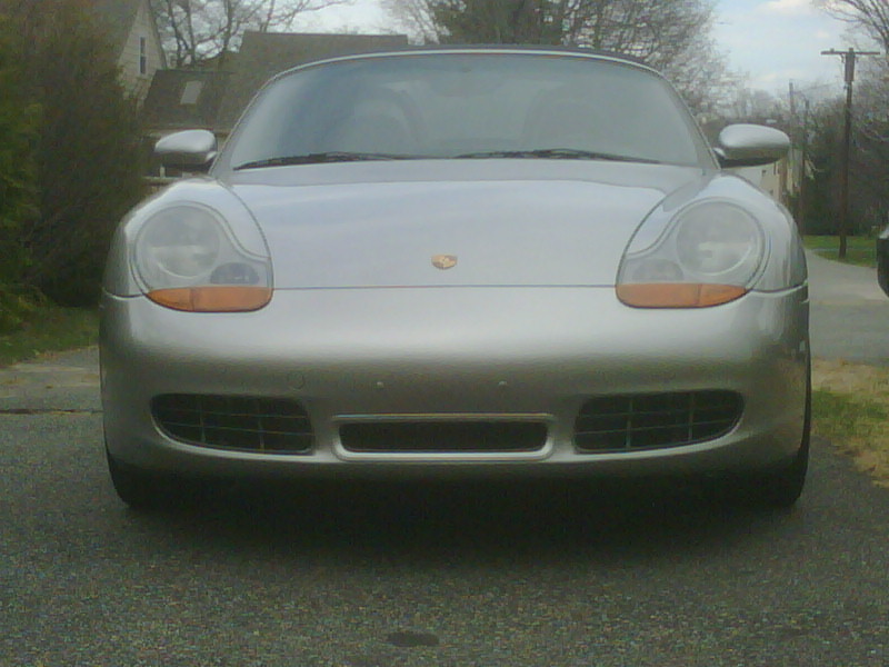

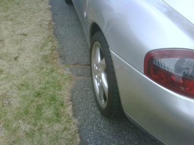

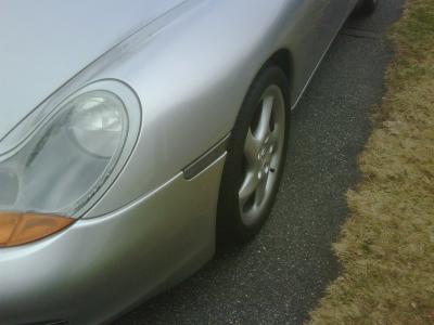

Having a wider stance is much, much sexier in my opinion. I hated the gap between the outer wheel well and the actual wheel, it was just plain ugly. The front is a 7mm increase on each side and the rear is a 14mm increase on each side which seems perfect to me. I didn't have the foresight to take before and after pics, just after pics, so although you can't tell how dramatic a difference it makes without it-it still looks way way better!
