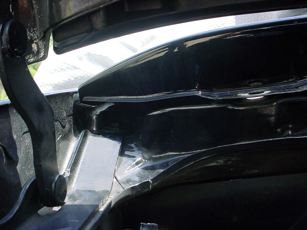

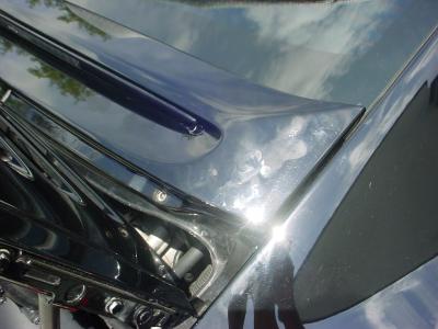

On the exterior of a 997 Carrera coupe, I need to remove the panel that is directly underneath the rear window (it houses the third brake light). The only real instructions that I've found online were:
1. Open the engine compartment lid
2. Remove the 3 torx screws holding the rear panel above the engine hatch
( which contains the brake light assembly )
Anyone know if there is a step 3? I removed the three T30 screws, but I still can't get the panel off -- it's stuck. You can see my hand in one of the attached pictures lifting it as much as it will go before it won't budge any further.
Is it supposed to just lift right off after taking the screws out or is there a trick?

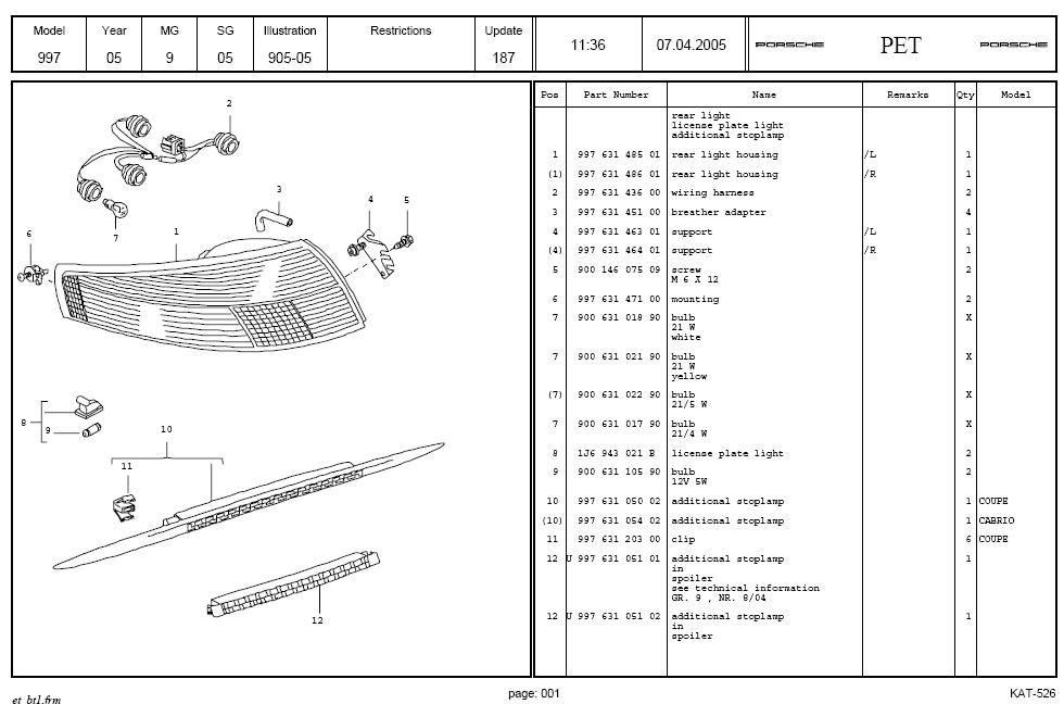

Is it possible to remove the third brake light without removing the panel? My third brake light has moisture inside the lens, I would like to clean it up.

You could on the 996 but I don't think so on the 997-1. But in the 996 they were bulbs and in the 997-1 they are LEDs
Check your owners manual - if you can it is there in the bulb replacement section.
This is what is says in the owner's manual.
Additional brake lights
The light-emitting diodes of the additional brake
lights cannot be replaced individually.
f Have the defective brake light replaced at an
authorized Porsche dealer.
Paul
