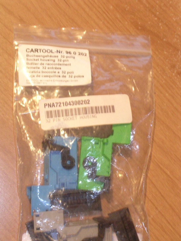

During install of a four stalk kit to enable OBC, I broke the grey connector. This unfortunate event then began a frustrating on-again, off-again two year search for the correct replacement.
The good, and persistent, people at Sunset Porsche came to the rescue and were able to track down the correct part. Please give Chris a call at Sunset.
The part is actually sold as a three plug set and the part number is PNA72104300202 (32 PIN Socket Housing). This means that you will get a blue, green and grey plug. On a side note, there are subtle molded differences with each colored plug, so you can only slip a green plug into a green socket. Chris had to special order the set from Germany, but the cost was not huge....less than $25 with shipping.
cheers
Go talk to a service person at your local Porsche dealership. They have toolboxes full of replacement plugs to use in case one breaks while they're working on a car. The plugs aren't listed in the computer, but they can fish through and find you the one you're looking for.
