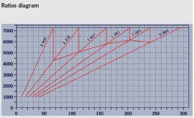

I guess what I'm looking for is a way to know, for any given speed, what the RpMs are in each gear. I never watch the speedo but I do drive on the tach, but if I am in 4th at 5,000 RpM what would the RpMs in 3rd, etc? Problem is that I don"t know until I get there!

Richard that is EXACTLY the informtion I have been looking for. If I read the chart correctly, it is telling me that the maximum RPMs for a downshift from 5th is 6,000, from 4th is 5,750, from 3rd is 5,000. I am just wondering whether there is any difference in the numbers you show between the car you show, and my car, which is a 2006 C2 USA spec with standard 18" wheels. Really helpful - thanks again.
The ratios diagram is for the MY2005 G97/01 transmission, and the SIT also shows a ratio tables and speeds which is based on 18" wheels. I believe the rolling circumfrence of 19" wheels would be very close to the 18" because of the lower profile tyres. You can read the complete SIT, which is a mine of information, by becoming a Contributing Member here. It is worth every cent, just for the SITs and TSBs alone. Sorry for the blatent plug, but :renntech:
Richard, I have done the chart for my car. According to the manual my gear ratios are 3.91, 2.32, 1.61, 1.28, 1.08 and 0.88 with a 3.44 final drive. I am running 265/40 ZR 18 at the rear, which gives me a rear tyre circumference of 210.24 cm, versus 207.22 cm for the 295/30 ZR 19 rear tyres and 209.10 cm for the 305/30 ZR 19 rear tyres. The maximum downshift RPMs come out a bit different. I am assuming of course that my excel skills haven't produced GIGO (Garbage In Garbage Out) but it's good to have done the analysis. Thanks for the inspiration and I will certainly consider joining. I am one month into 997 ownership and loving every moment.
