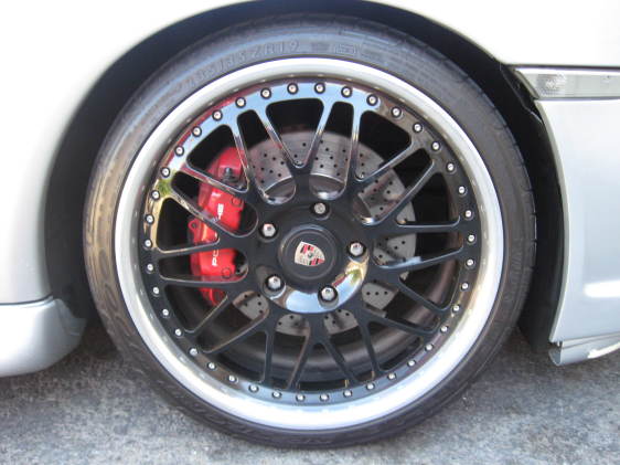

I was at a PCA event at California Speedway a couple of weeks a go and there was a vendor there that does mobile wheel repair.
They can fix minor curb rash on certain wheels on the spot. I saw them working on a customers wheel (still on the car) that was very similar to mine. (See picture of my wheel.)
They guy used an electric grinder and a polisher. I must say I came back later in the day and the customers wheel looked amazing. Any members familiar with metal working think this is possible to do yourself?
If so what kind of tools would you need?
I just grazed the edge of my driveway yesterday and got another blemish on my rim. Sure would like to be able to fix this myself if possible.
My wheeels are not chromed just polished.
Thanks !!

It's hard to see any damage on your wheel, even with the photo enlarged, so the damage might be slight enough that you can fix it yourself.
It does take some experience to get perfect results (i.e., where no one can spot the repair) but you can certainly get to 90 or 95 percent with some effort and patience.
A grinder and different grades of buffing wheels, with different abrasive compounds (jeweler's rouge, etc.) can get a surface with relatively minor damage flat and polished again.
In the case of the lip on your wheel, it would be helpful if you had one of those flexible (cable) attachments for the grinder and the polishing operation. That gives you all the maneuverability you need.
For the grinding part, work in reverse order of abrasiveness, so that you don't use anything more aggressive than necessary. For the polishing, start with the coarser compounds, then use successively finer ones until you get the desired result that matches the gloss on the rest of the wheel. Don't skip any grades of compounds when polishing.

Maurice,
Thank you for the great information. That picture is an old picture of the front wheel. The damage is one the rear. Can you direct me in what kind of grinder (electric tool) to buy? Where would be the best place to buy it? What accessories should I get?
Thanks again!
Phillip

Phillip:
I use air tools, in this case both an in-line mini grinder and a mini angle grinder. IIRC I got them from Harbor Freight Tools about 10 years ago.
If you don't have a good compressor(mine is a massive "Quadzilla" :P , I think you might be able to use one of the more powerful Dremel tools, although I have never used a Dremel personally for that purpose. I know that Dremel has a good flexible shaft attachment that would give you excellent control and allow you to approach the damage with the best angles. They have all sorts of attachments that you can get. If you go to Home Depot, ask for the section that carries buffing wheels and bonnets and compounds such as the jeweler's rouge I mentioned. Look around and you'll get a good idea of what I am talking about. Then you can use the Dremel to apply the compounds after you have smoothed the surface with the grinding wheels.

I found this kit on the internet. Looks like it would have everything I would need, What do you think? :huh:
http://www.autobodytoolmart.com/pc-16391-1...it-3956-02.aspx

Unfortunetly it's a big blemish. I ground it against a cement curb :angry: The are some minor blemishes on the other rear wheel. I think I will start with that one.
I figure I can give it a try and if it doesn't work out I will send them out to a pro.
I will go ahead and get the Dremel kit anyway. Looks like a good addition to my tool kit.

Okay,
So I bought a Dremel tool with accessories. I bought three levels of polishing compounds as well. It was kind of scary :o but I started grinding on the wheel with the worst damage (the cement driveway chewed it up pretty bad.)
I figured that If I made it worse I would have it done by a pro. To my suprise I did a pretty good job. :D It looks much better than when I started.
I realize that I need a much larger surface area tool to sand and polish. The Dremel comes with very small attachments. I will purchase additional polishing/sanding heads to finish the job.
I will post pictures once I'm done (I'm only about 50% there now.) It won't be prefect but you will really have to scrutinize it to see the flaws.
It will be nice to know that I can fix my own scuffs in the future (I'm sure there will be more.) :cursing:
Update later
