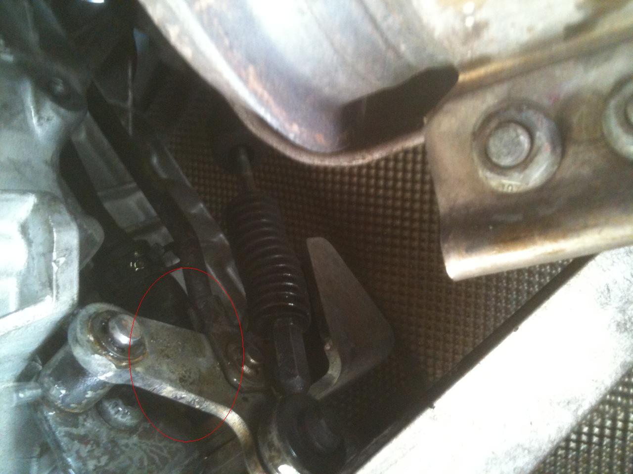

I hope you don't mind me jumping onto this thread, but I have a related issue and need a little help. I have noticed a steadily rising running temperature for about a month and finally last night I got a nice steam bath from the back of the car and all my coolant dissipated. I can see water leaking near where I am guessing the cooling system enters the tranny. (tiptronic btw) Any ideas what may have caused this or if it might be symptomatic of other issues besides just age and the car being driven like a Porsche?
About 14,000 miles ago I had the tranny rebuilt (heavily damaged torque converter) and replaced a 2.5L with 2.7L after IMS failure. Pedro Hi-Flow intake, and Crios exhaust mod.
I attached a picture of where it looks like the water is coming from. Any advice as to getting to that hose would be appreciated as well. (i.e. how difficult is it too remove that lever that's sitting in front of it? looks like a B)
I'm recently unemployed so I have the time to diy and not the money to take it to a shop. As such your comments are very much appreciated. Thanks
