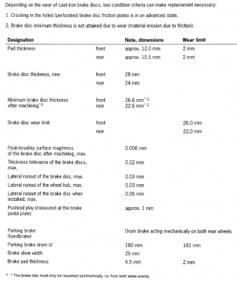

A lot of shops will replace or turn a rotor when they install new pads because it reduces the number of come backs. But turning or replacing is not always necessary. I am unsure on the turning of cross drilled rotors - I have actually heard it both ways. I think the real answer is yes they can be, but it is diffcult, time consuming to do right and requires good equipment, so most won't do it. A new rotor is probably cheaper.
In deciding whether to replace or turn, you need to consider:
* do you have any brake judder/shudder and if so, is it due to a warped disk (not as common as most people think) or due to a heavy pad deposit (usually the case) - if so, turn or replace makes sense
* do you have significant cracking on the rotor - hairline cracks working their way out from the holes is normal, but can become problematic when they connect hole-to-hole. also check for cracks and splits out to the edge - hole-to-hole or edge cracking means time for new rotors
* are you below the wear limit at the rotor's thinnest point - sorry, I don't know the wear limit on the 996 rotors, but on the front of a 986 I believe it is 26mm (they are 28mm when new) and it is 22mm rear (they are 24mm when new); i will tell you on my track 986, i have never reached the wear limit even with high friction pads - I always kill them with cracking first from the heat
* are you close enough on any of these things that you would need to go back soon to have rotors replaced and thus pay for extra labor - if so, then just do it now
Porsche rotors for the front, if you don't shop around, will be 190 each - that is expensive - sunset will have them, i suspect, quite a bit cheaper. And look around - there are also many aftermarket rotors that are good - but you probably want to find ones that have an anti rust coating on the hats, otherwise the cheaper ones will show rust on the hats - that is just an appearance thing. Zimmerman, I think is the Porsche OEM provider, and sells Zimmerman branded rotors that have the hats coated to stop rust - they are a good 50 bucks cheaper than the Porsche ones.
