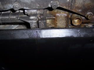

The coolant seems to have leaked from somewhere near the bottom of the engine, as it was dripping from the plastic protector panel under the engine when I looked.

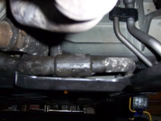

Here is a picture of a hose in the area where dripping seems to be occurring, you can see an orange drop under the shield, perhaps it's leaking either from this hose part, or the metal part to the left of this hose, where this hose connects.
On that metal engine part, I did see a few drops on the bottom of that part.

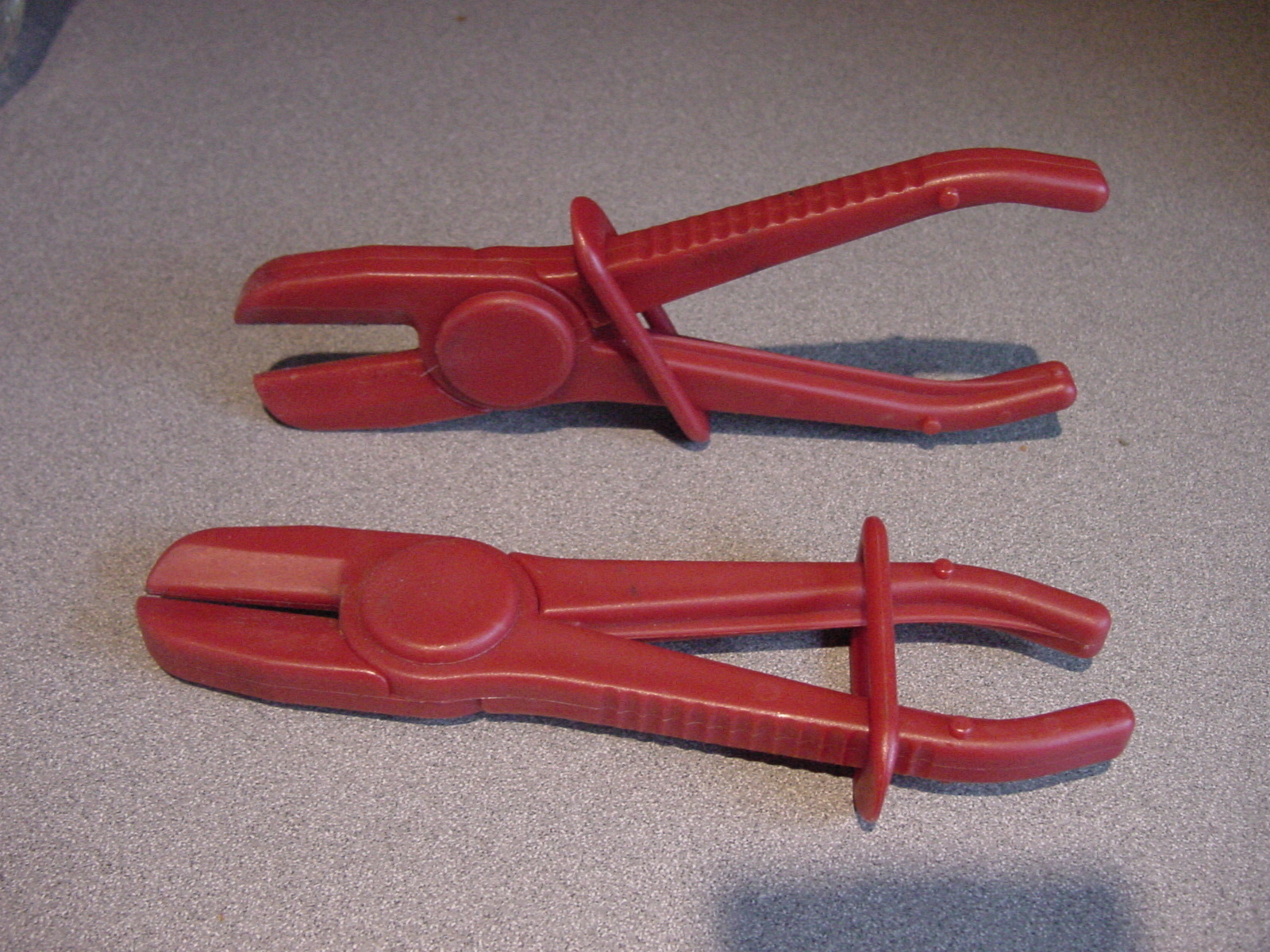

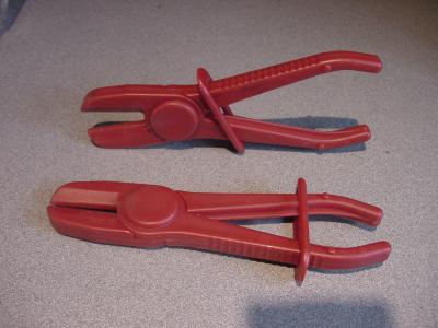

Once you have determined that it is the water pump, get a couple of hose shut-off pliers (cheap, plastic affairs available at Sears), to minimize the amount of coolant that you will loose out of the hoses that you disconnect. Here is what they look like:
I bought these at Autozone, but Sears has similar ones with some in bigger sizes which are just right for the job.

Yes, the plastic tray had a lot of coolant dripping form it, both wet and perhaps dried.
From below, the entire area on the bottom and surrounding the water pump has what appears to be coolant spray.
The Y hose & screw clamp have drips and remnants of coolant on their underside, but don't seem to be perforated.
