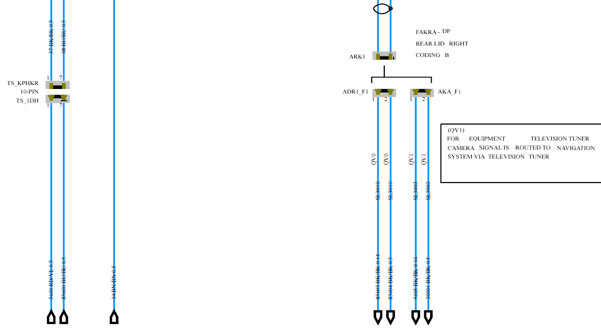

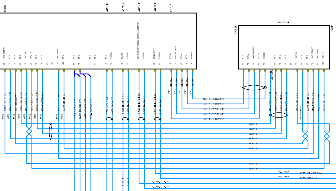

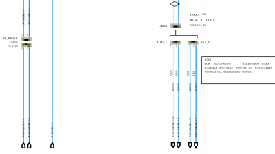

hi Loren, do you have by any chance a diagram of how these camera control unit wires connect to the back of pcm 3? i have looked at pics you posted before for ipod connection but that part of diagram where cam connector is cut off. tks
I think these are MOST (fiber optic cables).

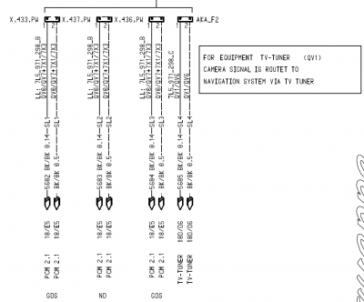

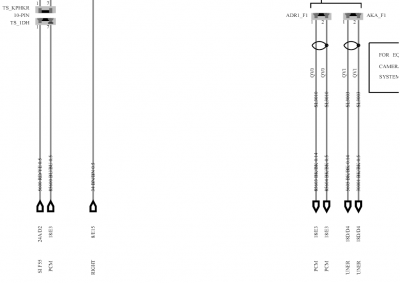

Hi Loren, many thanks but this is pcm2.1 diagram. do you have a pcm3 one? it is the most left part of this diagram that you kindly provided before

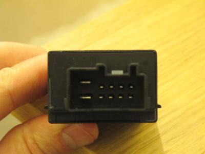

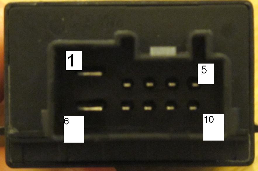

hello, can anobody with PIWIS look up how contacts are numbered on camera control unit? Picture attached - this is control unit side. thanks in advance. i tried to find this connector online but after few hours i am ready to give up

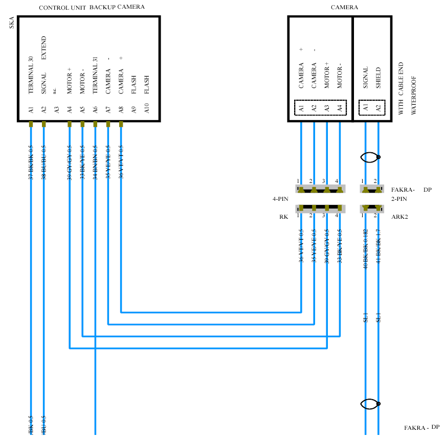

after some tries i figured out the pinout if anyone need it in the future (image attached)
Edited by SA321

hm. not 100% sure about second wire but my guess is this:
if you look at diagrams above there are 3 wires from control box iand two from camera (AV signal). 3 wires from control unit are:
-12
+12 (i believe through fuse 53 on left but check in the manual)
and control wire which goes to pin 6 on pcm lower connector
if two wires you are referring to are from control unit connector i would guess the two are +12 and control
camera cable connects through a different connector (yellow) from a rear door harness. i have to look up which pins camera signal goes onto but will only be able to do it a week from now. maybe somebody can post a pcm3 pinout before that
