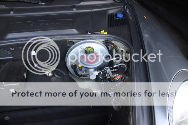

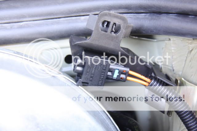

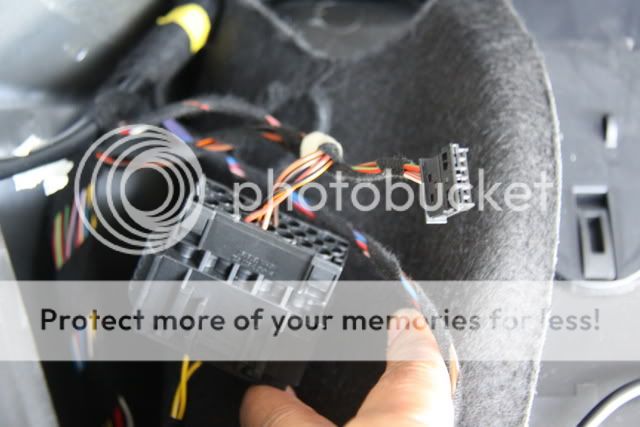

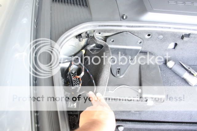

Thanks Loren, I found them and just got done digging into my trunk. Here's the locations of the optical cable and power areas to tap into if your 997-1 C2 (I have a 2005) my car didn't come with the changer and is the non-bose system.
All pictures are located here, I'm only adding 4 to the thread.
http://s647.photobucket.com/albums/uu196/e...r%20in%20trunk/
Far view of optical cable area in trunk
Close-up view of optical cable
Far view of power taps
Close-up view of power taps, Hot Wire (green/red) and Ground (brown)
