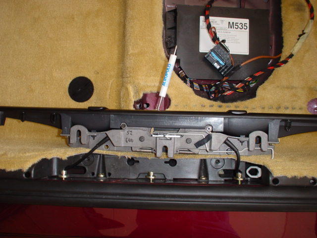

This is the levers removed from the door sill. Yellow lines are to the locking cam that you need to rotate out of position if that is the problem.
Dam thanks worked like a charm, my porsche's 1 month rest is over.. Time to hit the streets
