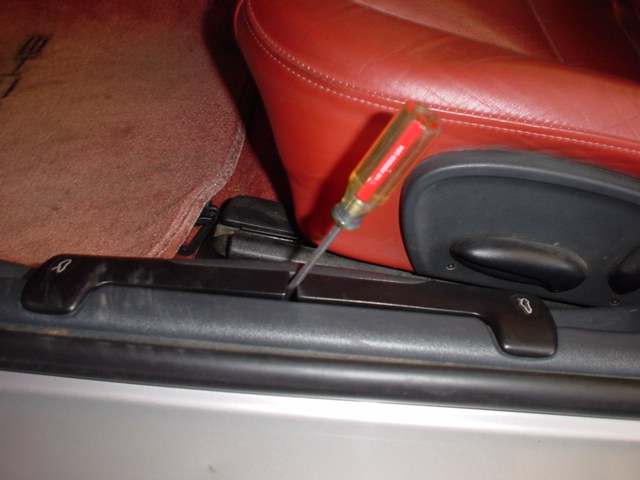

Loog at the attached picture and see the gap between the two levers. If you look on your car you should see a metal tab down in the gap. You can use a thin flat screwdriver and push the tab (I forget which way but I think it is sideways) and move it out of the way. Once you do that the trunk releases will be unlocked.

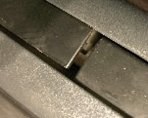

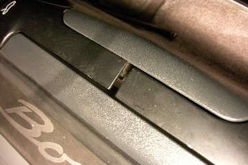

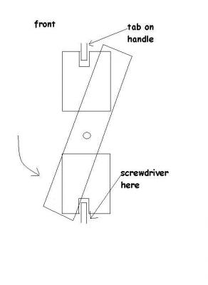

Okay I figured it out. There are two pictures and a drawing as the pictures are not very clear. Picture 1 looks forward into the gap between the levers. The second picture is an enlargement of the gap. The drawing hopefully shows what you see when you are looking into the gap.
Looking forward into the gap you will see a metal plate that has a U-shaped cutout. You will see that a part of the handle sits in this cutout. The locking mechanism is a plate that rotates underneath the U-shaped cutouts thus preventing the handle from moving.
To unlock the lever you rotate the plate out from underneath the U-shaped cutouts. It is easiest to do this under the trunk release lever. You reach in with a thin screwdriver or an awl and push the plate from right to left. This unlocks both levers.

Get a strong light and a small thin blade screwdriver. The screwdriver must be at the angle in my pic since that is where the cam is. The cam is horizontal and rotates side to side. I forget which direction you rotate the cam to unlock the levers - it is either left or right. Stick the screwdriver in so that the tip is on the cam then try to rotate the cam. You can only move the cam a little bit at a time. Take the screwdriver out once in a while and see if the lever pulls up. If that does not work then try the other directiion.

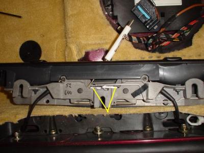

This is the levers removed from the door sill. Yellow lines are to the locking cam that you need to rotate out of position if that is the problem.

Look at the diagram (be sure to click on the diagram to enlarge it as some of the detail may be missing). The cam rotates. As you are looking toward the front of the car you rotate the part that is under the rear trunk lever from right to left to unlock (the diagram shows the unlocked position. The cam would be vertical in the locked position). If you are moving the cam from under the front lever then you move it left to right.
