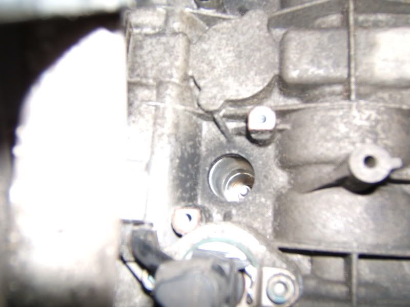

Little Update - I have just removed my first coil pack and i do not think there are any tubes fitted ? Was there a redesign 03 plate ??
I think if the coil packs sit at an angle they have tubes, if they sit 'square' horizontally and vertically then they do not.
Anyone confirm this, pic below.
