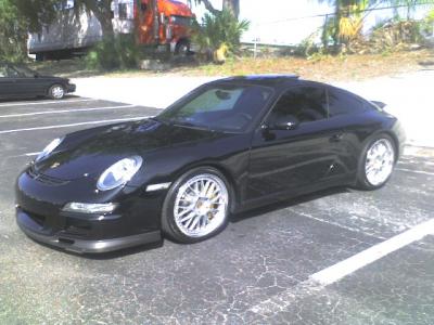

Boy, it seems the '05's have had their share of little problems! Mine had everything from a CEL warning to a floppy rear-view mirror, but fortunately the local dealer took care of all that stuff, while it was still under what was left of the warranty.
Just be patient and get all the little gremlins fixed. And don't be afraid to drive it HARD (and change the oil and filter around every 7500 miles); it's a terrific car! Oh, and I like those wheels!
